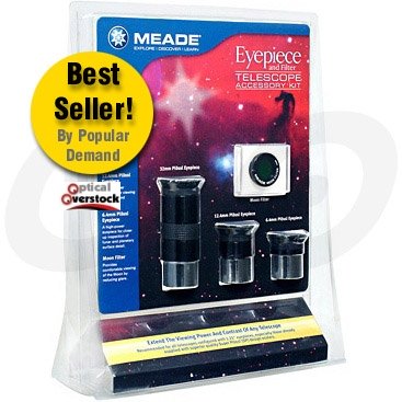

A ver que os parece ésto. Es de Ebay USA
Meade 32mm,12.4mm, 6.4mm Plossl Eyepiece + Moon Filter Kit
por $64'50
re.: Ayuda con telescopio.
respuesta #13
: Mar, 09 Mar 2010, 18:21 UTC »
* 4-element series 4000 design
* 52° Apparent Field of View
* 7 Layer Fully Multi-Coated
* Edge-blackened optics yield optimum image contrast
* Includes custom fitted soft rubber eyeguards
* Solid Metal Construction
* Glass, Not Plastic lenses
* Moon filter to reduce glare (The moon can be extremely bright through a telescope - This is a must have for lunar observing!
genial
si son Plossl
